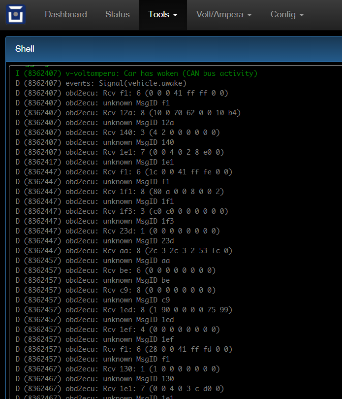

When waking up the car with volt.ampera template I get lot's of data. The solution to get data was, wake up the car :-) (sorry) So the good news is that it can communicate. It reads out the charge status. Range does not match but that's understandable. [image: image.png]

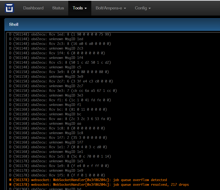

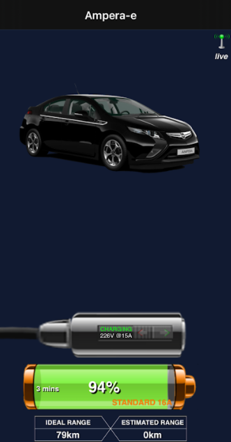

[image: image.png] Switching to my new template I get [image: image.png] In verbose level the module crashes because of to much data.
How can I port the volt/ampera readings to the new templates. Must be something with the connectivity(can) I gues ?
