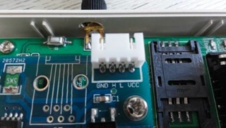

It has been pointed out that the label "GND H L VCC" on the v1` PIC boards using the little white connector is incorrect.
This wasn't a problem with the RJ11 version, but when we switched to little white connector, the factory mis-labelled this. The label is mirror-image inverted.
Since we found out, we have been sticking little paper labels to cover the incorrect part of the board, but some early boards don't have this.
The connections themselves, and cables we use, are fine it is just the label that is wrong. So, please take care when making up your own cables.
