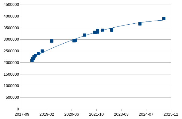

> This is the growth over a selection of main releases:
> Date          Size       Version
> 2018-04-08    2100352    3.1.003/ovms3.bin
> 2018-04-17    2111536    3.1.004/ovms3.bin
> 2018-05-01    2172176    3.1.005/ovms3.bin
> 2018-05-20    2247760    3.1.006/ovms3.bin
> 2018-06-18    2311072    3.1.007/ovms3.bin
> 2018-08-18    2386640    3.1.009/ovms3.bin
> 2018-11-04    2503744    3.1.011/ovms3.bin
> 2019-05-12    2933840    3.2.002/ovms3.bin
> 2020-08-04    2943440    3.2.014/ovms3.bin
> 2020-09-02    2957216    3.2.015/ovms3.bin
> 2021-03-05    3189808    3.2.016/ovms3.bin
> 2021-09-29    3309536    3.2.017/ovms3.bin
> 2021-11-22    3318000    3.2.018/ovms3.bin
> 2021-11-22    3367696    3.3.001/ovms3.bin
> 2022-03-07    3396208    3.3.002/ovms3.bin
> 2022-09-03    3406816    3.3.003/ovms3.bin
> 2024-03-23    3675344    3.3.004/ovms3.bin
> 2025-07-18    3895696    3.3.005/ovms3.bin
> So extending the partition size to 6 MB will buy us quite some time.

> Am 06.12.25 um 10:33 schrieb Michael Balzer via OvmsDev:
> Everyone,
> with the latest vehicle additions, the firmware size has now grown to
> 4,015,328 bytes in build 3.3.005-485-gc4664881.
> Our flash partitioning scheme is currently designed to provide three
> firmware partitions (factory, ota_0 & ota_1) of 4MB = 4,194,304 bytes each.
> So we've now got 178,976 bytes = ~4% left.
> Options beyond the 4 MB limit:
>  a) split features, e.g. vehicle support, into two or more builds
>  b) repartition into two firmware partitions of 6 MB each, reusing the
> factory partition for OTA
>  c) switch to an ESP32 WROOM module with 32 MB flash (possible?)
> We've got some time left, new vehicles normally don't need that much
> space, I just wanted to raise awareness.
> Regards,
> Michael

An HTML attachment was scrubbed...
URL: <http://lists.openvehicles.com/pipermail/ovmsdev/attachments/20251209/07ec4630/attachment-0001.htm>
Type: image/png
Desc: not available
URL: <http://lists.openvehicles.com/pipermail/ovmsdev/attachments/20251209/07ec4630/attachment-0002.png>
Type: image/png
Desc: not available
URL: <http://lists.openvehicles.com/pipermail/ovmsdev/attachments/20251209/07ec4630/attachment-0003.png>
