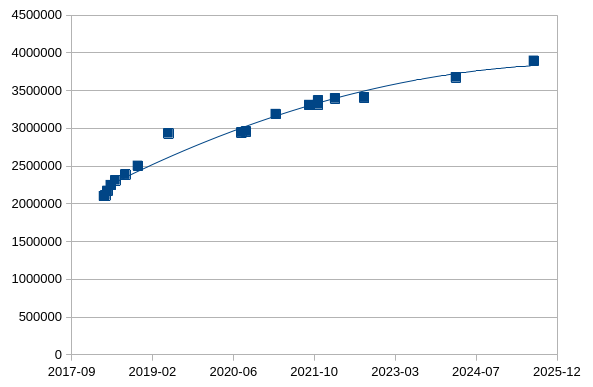

This is the growth over a selection of main releases:
Date          Size       Version
2018-04-08    2100352    3.1.003/ovms3.bin
2018-04-17    2111536    3.1.004/ovms3.bin
2018-05-01    2172176    3.1.005/ovms3.bin
2018-05-20    2247760    3.1.006/ovms3.bin
2018-06-18    2311072    3.1.007/ovms3.bin
2018-08-18    2386640    3.1.009/ovms3.bin
2018-11-04    2503744    3.1.011/ovms3.bin
2019-05-12    2933840    3.2.002/ovms3.bin
2020-08-04    2943440    3.2.014/ovms3.bin
2020-09-02    2957216    3.2.015/ovms3.bin
2021-03-05    3189808    3.2.016/ovms3.bin
2021-09-29    3309536    3.2.017/ovms3.bin
2021-11-22    3318000    3.2.018/ovms3.bin
2021-11-22    3367696    3.3.001/ovms3.bin
2022-03-07    3396208    3.3.002/ovms3.bin
2022-09-03    3406816    3.3.003/ovms3.bin
2024-03-23    3675344    3.3.004/ovms3.bin
2025-07-18    3895696    3.3.005/ovms3.bin
So extending the partition size to 6 MB will buy us quite some time.
