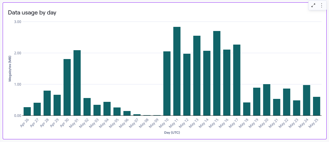

On 4/18/25 12:57, Craig Leres wrote:
> On 4/18/25 00:03, Michael Balzer via OvmsDev wrote:
>> As you're looking for a network issue, setting level debug for
>> netmanager, cellular and esp32wifi might help.
> Ok, I'll report back later after turning those on.
Catching up after being out of town for almost a month.
I have these components set to debug logging:
     canlog-monitor
     cellular
     esp32wifi
     netmanager
Attached is a log with 3.3.004-313-g78a49a59 which I booted on May 10th.
(I anonymized the GPS locations.) My other two modules are still running
3.3.004-323-gbc1f75c9 so the huge increase in cellular usage is purely
due to a single module.
		Craig
