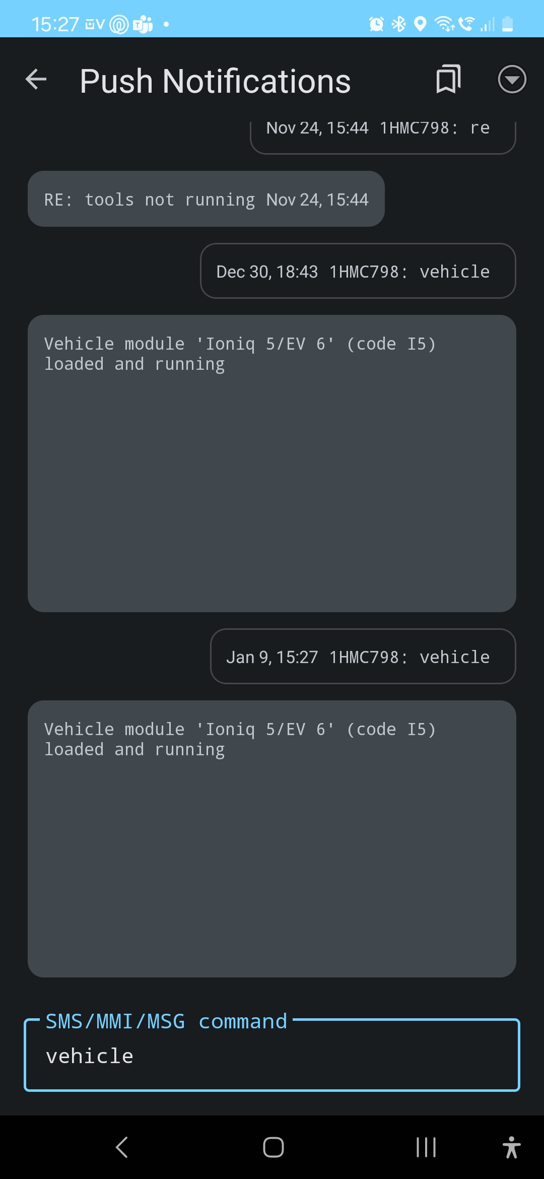

>>>>>>> One thing I found was in the  Push Notifications/ command area:
>>>>>>> Portrait mode:
>>>>>>> Note the really big boxes. This is because the date column is
>>>>>>> squished to a couple of pixels and it is displaying it wrapped
>>>>>>> downwards.
>>>>>>> Looks fine in landscape mode
>>>>>>> //.ichael
