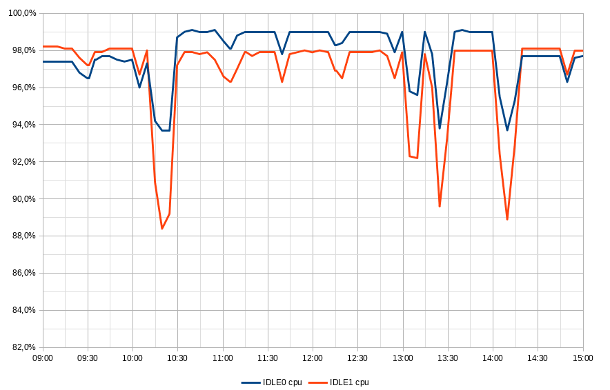

> From my task data today, here are some first impressions on our normal CPU load:
> a) Idle tasks:
> b) Active tasks:
> 10:00 - 10:30 was a drive from home (wifi) to office (no wifi), then another drive 13:00 - 13:30 and back home 14:00 - 14:15.
> Driving load on the NetMan is caused by the web dashboard. The half hour peaks are from the 12V topping from the main battery the Twizy does when parked.
> So that's nowhere near "too much" in terms of CPU load -- normally. I'm waiting to catch the issue situation with this instrumentation.
