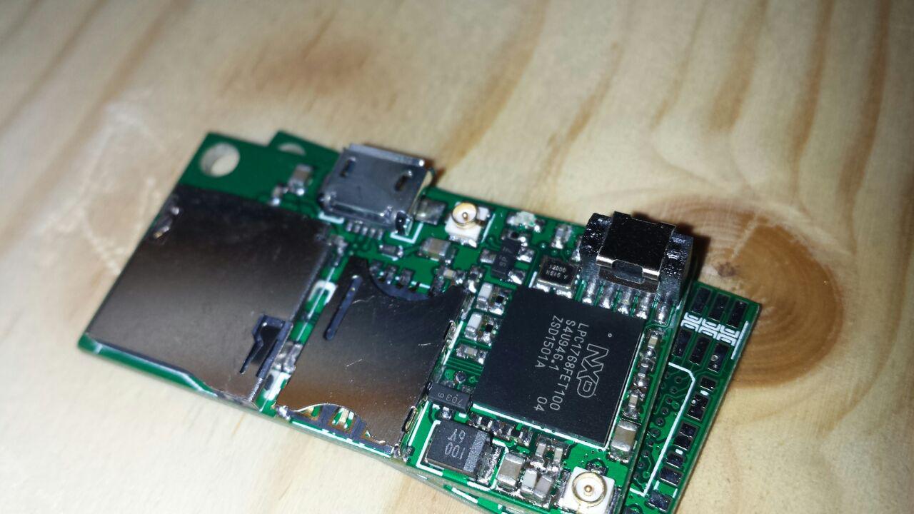

> On 4 Feb 2016, at 10:29 PM, Mastro Gippo <gipmad at gmail.com> wrote:
>  Well, to add my 2c, I've been working on a new version of the my own
> "OVMS" I talked about earlier with a LPC1768. I chose that MCU as it's
> better supported by the mbed with easy USB libraries. Mbed is disappointing
> me too lately, but that chip is well supported by FreeRTOS too and other
> toolchains are available.
> I think that a USB/serial/SD bootloader can reduce flash needs (I have
> 512k), as multi-car firmware will not be needed as users can upload a
> different version easily. I have a microSD expansion slot for logging and
> various storage.
> I'm still using a GPRS module, because here in eu I see no signs of that
> being discontinued anytime soon, and I can't find a 3G-4G module small
> enough. The GPS is a Ublox 7.
> The board is 4x2cm and can be directly stacked on top of an OBD connector.
> I was also planning on a LoRa/sigfox connection, but they're not exactly
> "realtime" (a Sigfox packet can take up to 6 minutes to reach the server).
> I think that kinetics are still not user-friendly enough, and that was my
> main reason to stick with something mbed/arduino compatible to allow more
> developers to make changes.
> Pic: http://www.mastrogippo.it/ct-1.jpg
> Regards
> MG
