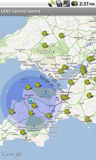

Here is an example of a range calculation and visualization I made:
https://play.google.com/store/apps/details?id=com.nikpix.LeafRangeCalc
And here is the integration of openchargemap I wrote in my previous e-mail:
https://play.google.com/store/apps/details?id=com.applications.lawsystems.leafcontrol
Here is a screenshot of the range visualization:
https://lh4.ggpht.com/D4dD0xdgJI8CEMAwhPa0sPp9zzsNf_j4SQksFTfZlowVdj9YfU6EFhqSzpxLf-NauQCm

Mark,
Display of range can be done in a similar way openchargemap was integrated in one of the nissan leaf apps out there - some of their guys can probably show you. I think it was concentric circles.
Integration of a particular database of charging stations is a mistake - there are at least 20 such out there. On android this could be done much more elegantly by intents - we can have a "visualize range on map" intent (with parameters like - max range, kWh available, weight of car, efficiency) and have different apps implement that intent and create visualization based on the input data. This would be similar in the way the contacts app in your android phone can dial a phone number with the phone app via dialing intent.

Felix,
Yes, I agree. This is really not something that can ever be 100% - we just want something to represent roughly what is possible and to limit the charge stations that we show.
A nice thing about circles is that it easy to visually estimate 50% (or whatever), so I think the user can do this themselves.
Perhaps the existing outer estimated-to-ideal circle at 50% transparency, then an inner estimated-to-N%estimated circle at 25% transparency? Or is that too complex?
We're also planning to have a feature of show-route-to-charging-station, for a particular selected charging station, and that will be google maps / whatever so will show real distance by road.
Regards, Mark.
